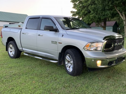

I'm a recent member of the RAM club, having just bought a 2014 Big Horn. I've been researching options for a slight lift/level and have decided on the 5100 shocks, front and rear with adjustable's up front. I'll probably set them at 2.8 and then I'd like to add a 1" lift coil spring in the back so I'm almost level or slightly raked and can fit a good sized tire when its time. I'm looking at the Bilstein 36-286539 as an option for the coil, or a General Spring HD rear variable, part #GSV-3409. I like the idea of the "increased payload" in the General Spring and I can't find any info that says the Bilstein offers any advantage, other than lift. I understand "increased payload" is somewhat of a misnomer, considering you can't truly increase it. But if the General Spring option is really a heavier spring than the Bilstein, it makes sense to go that route. I'm trying to keep the spring budget at $200, so these seem to be my only two options. Anyone here with experience with General Spring? Or any other ideas? I'd rather not do spacers..
Here's what I'm working with since we all like pics of good looking trucks :)
