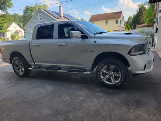

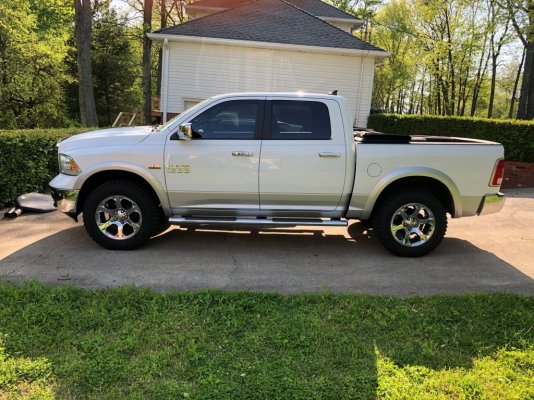

2014 Ram 1500 Laramie 4x4. Bilstein 5100's on all 4 corners. Front set at 2.8" with a 1.5" space on the rear. Stock wheels with Goodyear Ultraterrain AT 285/65R20 tires which are approx. 34.6" tall and 11.2" wide. Rubbed off a bit of inner liner on hard left turn and the clearance was close on the UCA so I put on a 1/4" spacer and everything is perfect now.

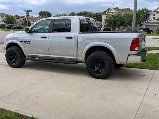

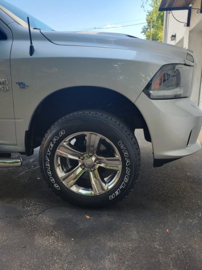

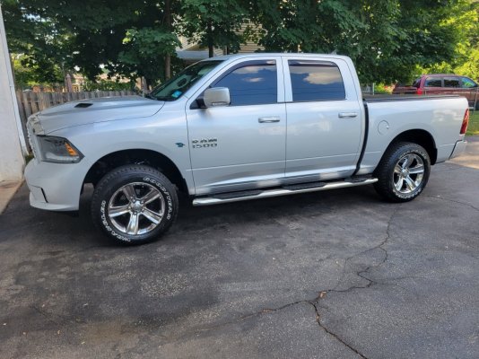

Bilstein's at 2.8 with bilstein rear shocks and bilstein rear springs

Your truck looks sweet. Everything looks clean on your truck. I just bought some in-channel window deflectors; I haven’t installed them but I’m hoping they look like yours.
Some questions:
Are those aftermarket Mopar emblems on the sides?
Did you install the Bilsteins yourself? Do you know if most folks on here do their own installs?
I have a 2016 1500 outdoorsman that I finally want to level. My stock tires finally need to be replaced and I’m going to be buying new wheels and tires and I also want to level as well.
thanks.
Some questions:
thanks.
Thanks sylverstruck I do all my own work. I've done a lot to my truck I have the factory wheels refinished in pvd chrome with goodyear wrangler adventure all terrain tires Kooks shorty headers magnaflow cat back S&B cold air intake billet tech catch can mopar pedal kit mopar stainless steel door sill covers westin pro traxx 5 wheel to wheel step bars bedrug liner T Rex lower front grill and those emblems you see are mopar performance I put on if you have any questions feel free to message me anytime

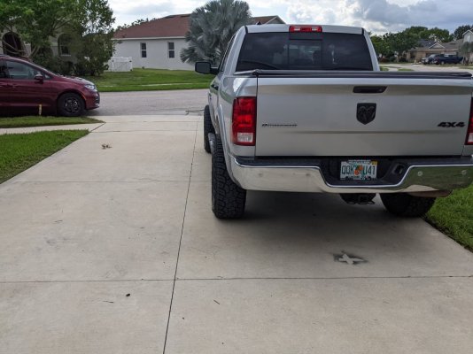

What is the backspacing? Is it 0 and is there any rubbing
I believe the backspacing was 0. There was very, very minor rubbing at full lock on the front on certain slopes and angles, mainly in the desert. I was able to take care of it myself by doing a little trimming and haven't had any issues since
What kinda of spacers did you use I’m looking to lift my truck but want to lift the whole truck 2-3”s I have a warlock so it’s gonna loose an inch from what ever the advertised height is

This is what I used. Been on for 3 months with no issues.

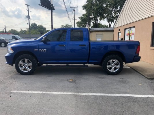

2014 ecosel with 5100 set at 2.8" and bilstien 1" coils in the rear. 22x12s with 285/50r22 nitto terra grapplers64860441106__08D8C46A-CE55-41EE-9EEB-637D3D0EC2B4.jpgdieIMG_1585.jpg

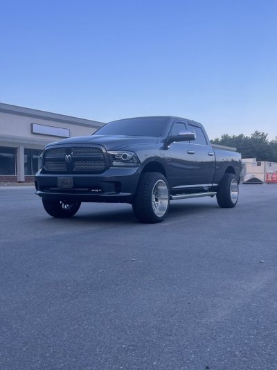

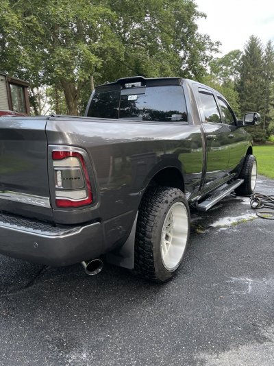

Bilsteins at 2.8 20x10 fuel contras -18mm offset with 35x12.50 patriots. 2016 ram sport
