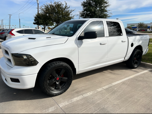

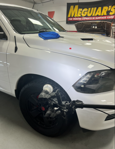

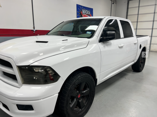

Its probably full of scratches and swirls like mine was. I would do this process honestly. Use carpro Iron x pink soap. Use a foam cannon and foam it. Let the soap run off. Rinse off. Foam it again. Wash it. Rinse it off again. Use a clay mit to decontaminate the exterior and the glass. Rinse it off. I would then suggest either using Carpro Hydr02 as your final sealant its a spray on and rinse off product. Two products that I would suggest if you want to go further. Koch Chemie P601 is a great cutter and sealant. Id go with a meguiars black finishing microfiber pad on a 15" DA. Or you could just apply Shine supply clutch to it and let it sit in the garage over night and then remove it. Obviously a full paint correction is what I am going to tell you to do, but that takes a lot of work and time. I had about 10 hours in mine. Then I went with the Koch Chemie Body Guard 2 Ceramic Coating. H9 and F6 from them is what I used. Every car is different and Meguairs 105 may work better. The Rupes Blue wool pad worked best for my paint to cut. Then I used a Meguiars black microfiber finishing pad to do the final polish before I coated it.
