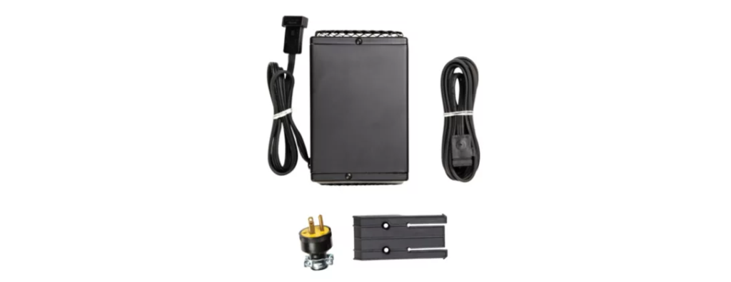

In car warmer. Have used this model for decades. Plugs into the extension cord along with your block heater. You need to run it out through the firewall. The plastic tab is so you can mount the heater to the hump or side panel, you only need clearance for the outlet, the rest is well insulated. You can use a regular electric space heater if you want to try this idea out before buying a dedicated in car warmer.

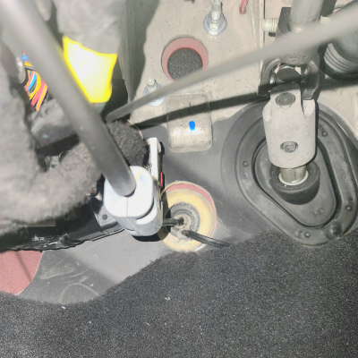

The power cord I run through the grommet for the emergency brake. Use an round awl rather than a knife so the hole doesn't spread.

Where does the unit itself sit? Like is it just chilling on the dash?
And does it have some form of built in thermal control, or does it just blast 900W of heat at all times? (I'd hope for $200 canunicstan copecs it has built in thermal control...)

The plastic tab is screwed to a convenient location and the heater slips onto that. It slips on and off easily so you can remove it if you want for the summer. Most guys screw the plastic holder tab to the center stack, the floor between the front seats if you don't have a full center console or to the passenger side foot-well. It can even be mounted in the back seat if you want. Like I said before, you just need enough clearance for the hot air coming out the front of the unit.
It has overheat protection but it does pump heat the whole time it is plugged in, just like your block heater does. That is why most of us use a timer, and set the run time based on how cold it is. The idea is to mount it close to floor level as heat rises.
