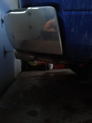

My 1.5" Zone BL did this to my exaust:
picture.php
I've since turned my tips up because of my bed step but a 3" BL would be twice as bad. You might have to do something like shorten up the exhaust mounts to get them to look better which will require some welding. Hope this helps.

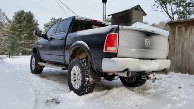

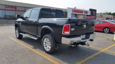

Here's a before and after of the exhaust on my last truck. This was a 3" body lift. In the second picture you can see how the shop adjusted for the body lift. I also added 5" tips.
This^^^
Hi
I know it's an old post but how did you trimmed your Chrome bumper without damaging the finish?
I really love your set up,
Did you used spacers with your stock wheels? (Brand,how big)
Thank

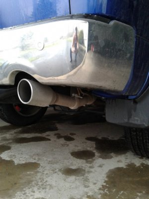

I just loosened the bolts at the swivel joints that are built into the exhaust and adjusted them up to match the new bumper height.20180404_170910.jpg 20180404_170937.jpg
so was this a 3" body lift and a level with stock 20" 33's?
Csanders1992
May 9, 2014
1,368
370
Would also like to know the specifics on this set up.
Including wheels spacers if any and tire size.
Thanks
If I remember correctly, he had a level, 3” body lift, 325/60s on factory 20s. He had wheel spacers too but can’t remember size. Probably 1.5”-2”
