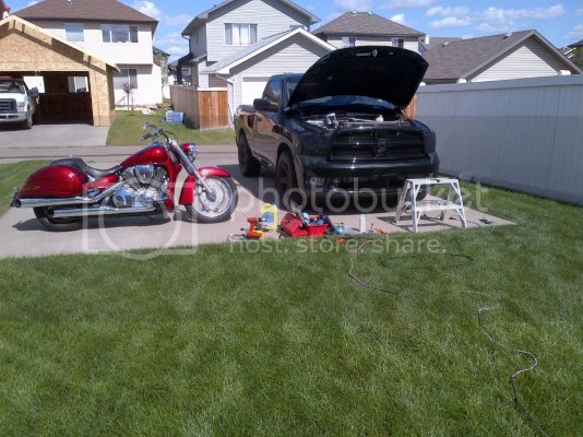

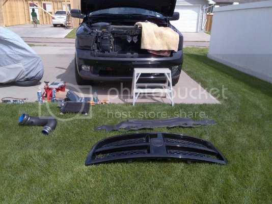

Ripp Stage III Vortec V3 supercharger kit, driveway installed...with basic hand tools

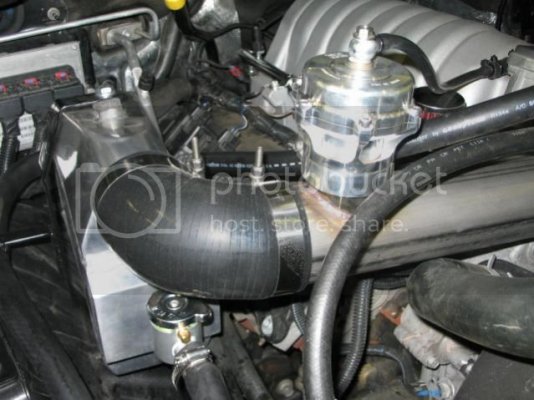

Alcohol Injection Systems (Water/**** kit) from http://www.alcoholinjectionsystems.com/
picture.php
picture.php

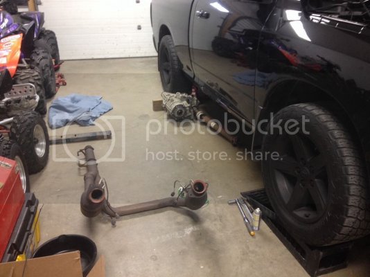

Transmission swap time... (must remove the exhaust, transfercase, both drive shafts)

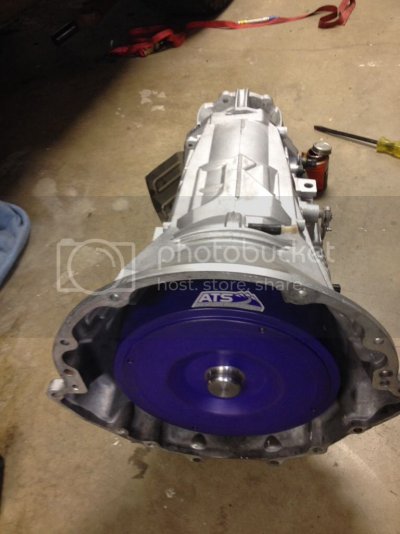

ATS 3000 Stall Triple Disc Torque converter for better holding power ($1000)

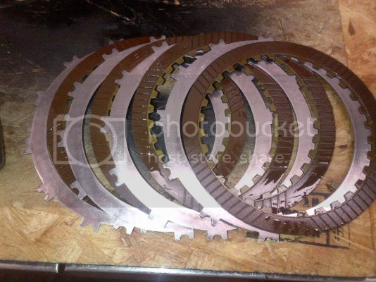

Stock Frictions/Steels
L&M Over Drive Frictions

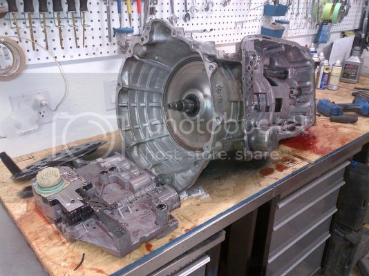

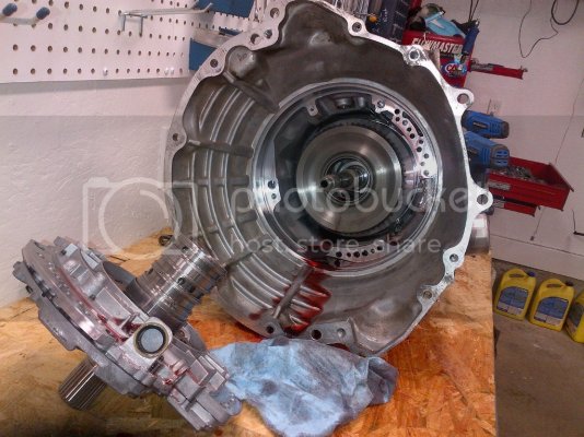

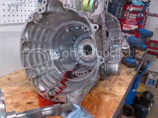

A Buddy and I just rebuilt my stock trans clutches by installing fresh frictions/steels
with just basic hand tools a manual and a youtube video
Drained Trans, Removed all the sensors, then the pan
and left the rear section on, since we don't need access the low/reverse sprag
Valve Body out
Pump Out

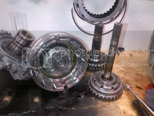

1st drum assembly out that houses the OD and UD frictions/steels
Cracked the drum open to pull out the frictions and steels
Burned up Over Drive frictions/steels came out first
Going in for the Under Drive Frictions
Under Drive frictions and steels were flawless
Next drum to come out holds the 2c frictions and steels,
But first we swapped the replacement OD frictions/steels Mike sent,
Re-installed my good UD frictions/steels and closed up the first drum.
(to minimize the amount of frictions,steels,bearings and snap rings sitting around loose.)
I sent a quick text to Mike to ask if it was still necessary to go onto the next set,
because the U/D frictions looked so clean, He replied right away, Yes 2C can often be the worst
...he was right.
Pulled the 2C frictions/steels, steels were burned up pretty bad, chunks missing out the frictions
Swapped the ones Mike sent me and re-installed the housing and snap rings
Everything went back in just about as easy as it came out,
Pretty much impossible to do incorrectly because the snap rings wont line up
with the grooves if you got something in the wrong order/position.
Total bench time, not counting a pizza break was probably an hour and a bit.
...and most of that was mopping up fluid and cleaning the old RTV off the pan.

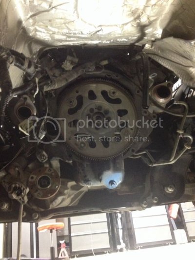

Within the next week or two we'll drop the L&M trans out of my truck
and replace the OD frictions in the first drum assembly.
Filters and Fluid ready to go,
just waiting on my header collector flange/reducers.

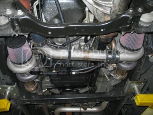

All the money your putting into transmissions wouldnt it be cheaper to swap in a 6speed from a challenger? I always wondered how easy it was to interchange the motors and tranys from different platforms.
Also dosnt procharger make a P1 kit for the Ram? Isnt that the kit that Stacy David did on Gears?
Also that TT setup is sick, you just cant ever drive it in the rain, or through water. but damn I didnt realize how much work it is to boost these trucks, I figured if the Hemi cars can do it we could do it too. Seems like thats not the case..

(MGH) Mike at L&M has built and tuned over a dozen Ram transmission for Boost applications.
there are other builds out there, but as far as I know he's the only one that includes tuning...a key factor.
Build the trans with superior frictions (from Diesel 68RFE)
Machine the backing plates to allow for substantially more of them (20+ total)
modify valve body and pump for higher line pressure (+40-50psi)
Then Tuning to make it all function in harmony.
take out any one of those and its only as strong as the weakest link = failure
If you send him your core, the charge is just $2500 (includes everything including tuning)
If you want him to pick up a used core and build it, you pay $500 more (if you want to keep your core)
If you want an upgraded Torque Converter, Mike recommends an ATS Triple Lok $1000 (his cost)
