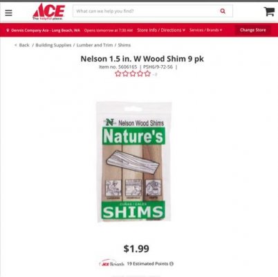

Or...just get some wood wedges...a package of them at Ace Hardware is cheap.
Use them to compress the pads.
So use the wedge to drive it between the pad and rotor to compress the caliper?

^ yup. Or take a screw driver and do the same thing. Compresses the caliper enough to pry it off without those two spots scraping anything.
