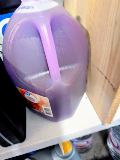

Do it yourself. My 2014 pentastar uses mopar part# 68163848AB Original Mopar 10 yr concentrate and diluted 50/50 with distilled water. The mixture is purpleish in color.
I got the Mopar antifreeze and burp kit from amazon.
This kit will help in burping the air from system. Plenty of videos on how to burp the air using this kit. Remember to drain/refill the coolant reservoir. I also attached a picture of the coolant when mixed.
