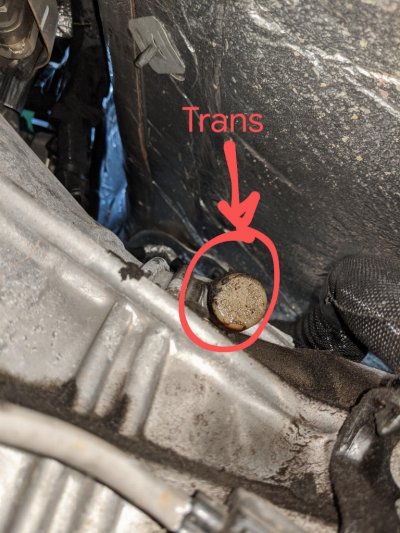

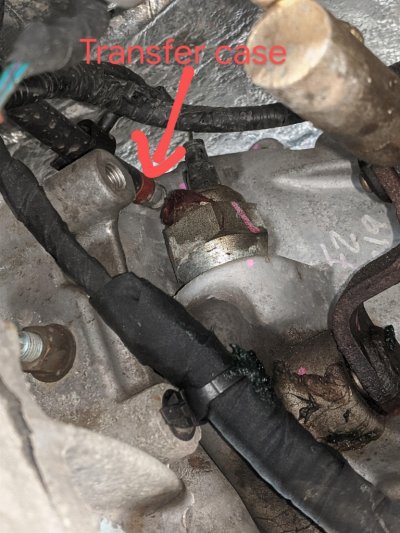

Here's some pics I posted on a wagon Facebook page. Trans is the hardest to see, it's literally on the very top of the bell housing. Tight to get to but the tube slides right off . The trans and transfer case are accessible from the driver's side. Transfer case has a longer hose just follow it from it's starting point that I have the pic of you should find the hose . my evap ran on the passenger side along the side of the trans can't miss it half wrapped in foil insulation.I ran the trans, Xfercase and front diff all up along the frame, up behind the shock and into the bay. The rear transfer case I extended to behind the d-side taillight and evap I ran up along the trans dip tube and into the bay59ce790990bebfb8cefabd34c30d195e.jpg5bc2f2eb8d5501454c53cffbf879bf09.jpgb0a69c61a54d1b2460f7e5111e153fc5.jpgd04e5b5cf7ea13d93421b18ca451ddb3.jpgfb2eb6cc8c54edd1dfe29d28ef161d73.jpgec30f86c1bd6d3dc95acef82adf54f73.jpg
