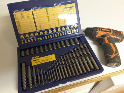

What was your tools of choice for the drill bits and bolt extractors

Not sure about the OP but I used the Irwin Hanson 35 piece extractor kit and I little 12v drill. But, in you have a broken bolt on the bottom row you Will need a 90 degree drill. It's Very tight.
I also used Irwin Hanson. The 10 piece kit works great. Got it off eBay. Part # 11119
Watch this video. He goes through it step by step. Yes, it's as easy as it looks, just takes around 2.5-3 hrs.
