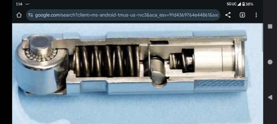

When the solenoid opens and sends pressurized oil into the lifter bores, it pushes in that pin that's perpendicular to the lifter body, in the middle, and collapses the lifter, which disables the valves for that cylinder.
In a non-MDS engine, pressurized oil can be fed to the lifter bores full time instead of just during cylinder deactivation.

Here is a cutaway of the MDS lifterView attachment 564588
Thanks for that explanation. Very crazy how it works let alone work at all.
