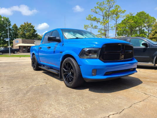

That's exactly where I am at now.
I feel like I am going to be on edge after it's fixed thinking something is going to break.
I wish it was cheaper to pull the one head off, change the valve and roll it.
Then sell it and get something, even though I love this truck. You won't find many in this color

Trucks in nice enough shape to throw an engine in. You should be able to pick up a low milege 5.7 and throw it in for the $5500 he was going to charge you to fix it
Dusty
Jun 6, 2013
2,103
2,865
Rochester, New York
Nice looking truck!!
Unless one can be sure of the where the used engine came from and how many miles, I would avoid one.
Yes, it's more expensive, but I'd consider a new reman block from Mopar. Keeping the current engine architecture has two distinct benefits: no turbo and no direct injection. Modern engine designs can present enough problems, maintaining a normally asperated engine design can limit them.
