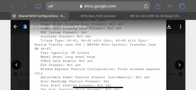

Ken226’s research matches my understanding.
What you should do is determine what t-case type AlfaOBD shows you currently programmed to. If it shows “246” (like in the options above) we may be able to conclude that BW44-44 and NV246 are controlled the same.
You could also try selecting “243” as your t case type. Since this was the equivalent transfer case to the the BW44-45 it may work

@TxRam409 try “analog 244” and let us know if it works. Based on the screenshot from the BCM dump above I believe it may fix your issue.

“Analog 244” is the setting I believe will work....I wouldn’t try “243” unless 244 doesn’t work.

Ok, nevermind the last question. I think i get it. AlphaOBD shows all of the cases listed in that log dump as being the same program, correct?

Ok, i think i get it from your log file above. AlphaOBD shows all of the cases listed in that log dump as being the same program, correct?
Btw: how do i create that log dump? Id like create one as a backup?
That is correct. All of those cases show they use the same programming based on the log dump.

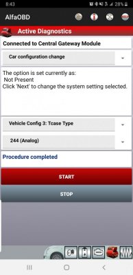

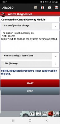

TxRam409
Nov 26, 2019
14
Port Arthur tx
I tired it multiple times and finally got it to accept the program. Gonna try it tomorrow to see if 4wd high works.

That sucks...I’m pretty surprised it didn’t work
Yea, same here. Im wondering if he generated a log file to make sure the change took.
Maybe time to try the 243?
Aside from that, the only thing left to do is to pull the shift motor to the transfer case and make sure its making the movements for the selector settings and double check the wiring connections to make sure nothings loose.
