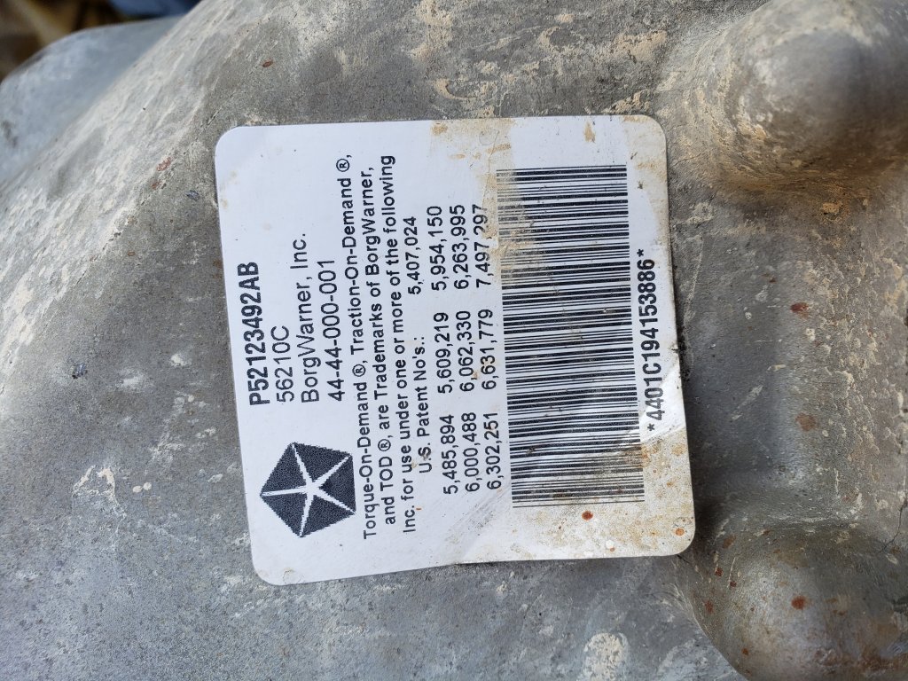

I just looked at my old Transfer case that my mechanic took out and it was the bw 44-44

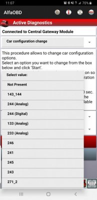

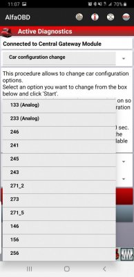

How do i get the Alfaobd to work with my truck? This is the options it's giving me.
M
Moparman16
May 19, 2014
207
263
Northern Ontario
2013 Ram 1500
It appears you don’t have the needed transfer case option available for your truck. That would have been a good thing to check prior to putting the 44-44 into your truck.
If I were you I would reach out to the designer of AlfaOBD (his name is Alexei) app and see if he can help you.
Good Luck

By chance, have you tried selecting the my2013 powernet bcm, to see if itll connect to what options it shows. If your truck was a late 2012, maybe it got a 13 computer and transfer case.
Or figure out what model transfer case the non-auto Rams used prior to 2013 and try that.
The NV246 and NV243 were the optiions available then. Im not sure which was the non-auto equivalent of the 44-45.

It gives me the option to select 2013, but when i do it gives me the list of options i posted above. Not the option for the BW 44-46 as suggested. I made an appointment to bring it to the dealership.

Some my past reading has hinted at some interchangeability between the pre 2012 and post 2012 transfer cases.
I looked up the part numbers for the 2009 - 2012 transfer cases and matched them up to the models.
The new venture gear 243 was the non auto part time case, equivalent to the bw44-45
The new venture gear 246 was the higher level 4-auto case. The equivalent of the bw44-44.
Its possible, maybe even probable, that the same programming that works for the nv243 will work for the bw44-45. Kinda the same way the 44-46 synchromesh program does.
And it may be that the nv246 program is the same as the bw44-44 program.
Its up to you how much experimenting your willing to do. But, experimenting is how it was discovered that the 44-46 synchromesh program worked for the 44-45.
If it doesnt work, well, your already going to the dealer anyway. Worst case scenario, they can just reflash you back to stock configuration.
Im curious as hell though. I have a 2013 sport, that ive swapped a 44-45 into, using the 4446 synchromesh program .
The nv243 is one of the options for my 2013, i wonder if it would work for the 44-45.
