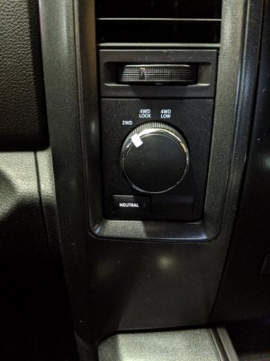

Well....out with the old (ignore the Saab in the background):
in with the new...FWIW, I did not have to re-pin anything on the harness.
And even soldered in white LEDs to the new switch!
Works great. Glad to know the 44-44 is gone!
rQGPM4X
M
Moparman16
May 19, 2014
207
263
Northern Ontario
2013 Ram 1500
rQGPM4X
You didn’t have to re-pin anything because your 44-45 came with an encoder motor. You only have to re-pin if you are reusing the 44-44 encoder motor

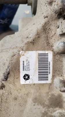

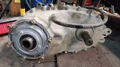

Got a BW 44-45 from a if I recall correctly a 2009 with a little over 100k and a 4.7l v8 for $300. Best deal I could find around me, being in Fairbanks Alaska. Getting ready to swap it into my 2014 Sport this weekend, I'd be lying if I said I wasn't nervous at all. Anything I should know before diving in? Im pretty mechanically inclined but I've never done anything with a T case. But I grew up helping my dad who's a heavy diesel mechanic. So garage work is nothing new to me. Usually involves super trivial stuff aggravating me and wrenches being thrown... You know, garage stuff lol
I don’t think the BW44-45 was used in the 2009 Rams. Before you go forward with the swap you should verify that the transfer case you bought is in fact a BW44-45. There should be a tag on the transfer case indicating what model it is.
Falcon1772
Oct 23, 2017
72
18
From what I've read I think you have that backwards. I think they didn't have the 44-44 as far as I know/read.
This is what I have. 84971465_142857000120883_845763808877084672_n.jpg 86218519_193039938736508_7804209435168997376_n.jpg 84258178_195755894816176_4552294471923924992_n.jpg 84524626_277650213196961_1397673458669715456_n.jpg
