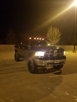

Ok, finally had some time to install lights. Was a very interesting project. Took me about 2 nights. First night to lay every thing out and drill, second night to wire. Turned out perfect! Plan on doin a little write up here shortly on some things I came across during install. Even remebered to snap some pics during the process.

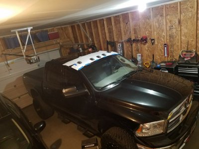

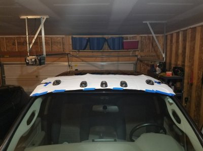

I purchased the factory mopar kit 82211190AB clear lens off ebay for $86. Kit came complete with wire harness, template, hardware, incandescent orange 194 bulbs, and instructions. Insttuctions are kinda vague, but you get the picture. I layed stencil on top of truck and got it cenetered. It took about 45 min to get all lined up and even . The 3 middle lights are aprox 3.5 in from windshield and the outer 2 are about 5.5 inches off windshield. 3.5" from outer lights to door jam. Secured with painters tape. Measured 5 more times and began center punching each point, 15 in all. I then took a 3/32 bit and drilled pilot holes. I tried dipping the bit in some grease to catch the metal burs, this did not work. It just slung it off and made a mess. Word of caution. THERE WILL BE METAL EVERYWHERE! Have a vacuum handy. I then removed the template after drilling all pilot holes. Put painters tape back over holes and continued drilling. 1/4" bit for the 10 holes to fasten lights to cab, and 7/8 for center hole. I only had a 3/4 step bit and it was a PITA to get the plugs up through those holes. Wasnt about to drop $40 on new step bit though. Deburred holes and painted bare metal with primer. Night one done.

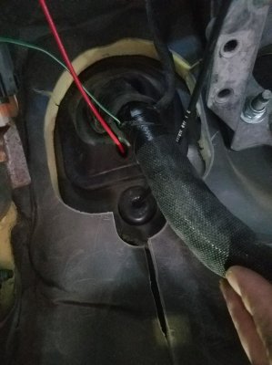

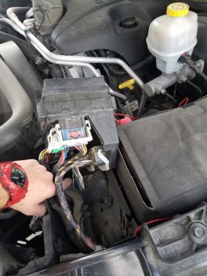

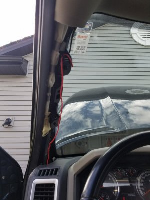

Of this entire project I was more leary about dropping the headliner than drilling holes in my roof. So, I only went as far as I deemed needed. I removed both front A pillars, upper center console, and visors. A pillars are a 10mm socket, visors are like 8mm and visor catch is a small torx. I was able to get enough play in heafliner to do all the work without removing the B pillars. It would have made things easier by dropping it more, but I'm used to working in tight olaces with my hands and I didnt want to deal with it. So, routed the wires up through the center console hole, and fished them up through roof holes. This was where the 7/8 step bit would have made things easier. The light sockets are hard molded rubber, and not very pliable. Took some coaxing but got the sockets up and through. Ran power down drivers side A pillar. I routed a piece of 16 ga wire through my fire wall into engine bay for power. The instructions state to get power from pin 7 on TIPM, wht wire with green tracer. I located wire and tapped. That particular wire is the turn signal feed. Save yourself the time and locate the correct wire at the headlamp. It also happens to be a wht wire with green tracer. I thought since my instructions were 2013 rev. they would have the correct wiring. There are lots of other threads reffering to the wrong wiring instructions from mopar. Use a volt meter and check the plug at the headlamp, and save yourself some time! Vacuumed out headliner and put everything back together. Fun project. Feel free to ask any questions. Would be more than happy to help. Cheers!
