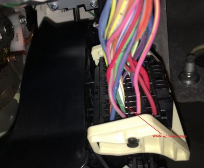

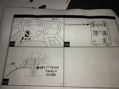

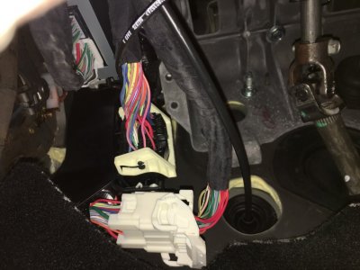

Ok, got the holes drilled, primed (and dried mostly with a heat gun), lights installed, wiring done. I'm going to start putting the headliner back up, I only pulled down the front part (removed A pillars, and visors), and did the work by reaching in carefully.
One question:
The instructions are kind of vague as to where to wire it into on my truck (shown as "2013 <" in instructions). It says connect to L77 in "Cavity 4 WT/BR (which I assume is a white wire with a brown stripe?). Problem is, I'm not 100% sure I have the right connector because my connectors do not look anything like what is pictured in the instructions. I put a volt meter on what I "thought" might be the right wire, and it only shows 4 volts which is not correct for a 12v light. (yes, I had lights on!) I'm pointing at this white/brown wire in the pic below.
Can anyone point me to the right wire and/or connector I'm looking for?
Pic of the wire I thought would be it, a pic of instructions, and a pic of the general area the connectors are (where BCM is indicated in instructions).
I still need this answered though, not sure which wire to splice into?
I would skip those wiring instructions altogether...mine were wrong, as have been many others. As I posted previously, the wire the mopar instructions told me to tap into ended up being the ledt turn signal. So, all five cab lights flashed with left blinker. My advice would be to locate the 12v @ the front left headlight with your volt meter. Its one of 3 wires. Its a sure place to tap, and thats were I ran off with no problems.
Thanks.... hmmm... that is screwed up! Well, wiring into the headlight would make them only come on when the headlights were on, instead of with the parking lights as they should. I guess I could do the same with a parking light, but that is a l-o-n-g way to go with a couple of wires including having to fish thru the firewall... when I have them all right there under the dash.
Somebody on the diesel forum just did his, same truck, he pointed me in the right direction. Going out now to see if I can find it.
