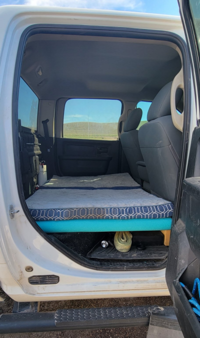

I did the Level 2 seat mod, removed them. You be amazed on how much the rear seats block the road noise. I just
only a year late for the reply
take the suckers out

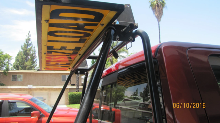

I have had a sign that was mounted horizontally just above the 3rd Brake Light & the space between the Cab & the bed.
I had to remove that sign, because the regular auto insurance agents, mentioned that it indicates a commercial business.
The sign partially blocked rain from hitting the rear of the cab.
