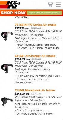

So I'm looking to add an air intake mod to my new 1500 Classic, but I read that there are certain laws restricting choices in California. Does anyone know what the law(s) are, or can point me to them? And, in that case, can anyone recommend top choices for an air intake that's legal in California at <$200 and >$200?
