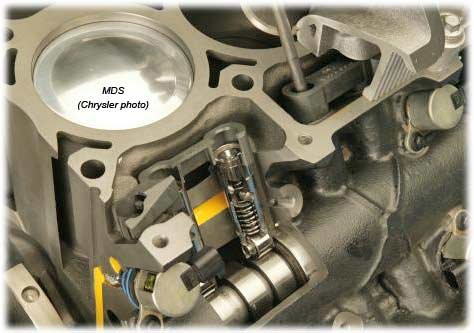

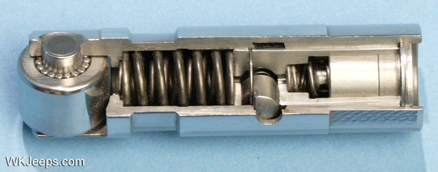

Correct me if I'm wrong but it is my understanding that the pressurized tappet oil supply is largely responsible for roller and lobe lubrication. Some of the oil that enters the tappet is permitted to pass through to the roller as shown in the following image.

That is an MDS lifter shown. They have a hole in the side of them to receive oil pressure to unlock the pin for MDS activation, it’s not for lubricating. The non MDS lifters do not have that hole in the side.
We have a hemi apart in the shop getting lifters, so we looked at it. There is a passage through the block and cylinder head that goes into the rocket shaft which then goes to the rocker arm, pushrod/lifter. Can’t see inside the lifter but I would assume there is a hole to allow oil flow to the roller/cam lobe. So it looks like there is somewhat pressurized oil reaching the cam lobe, not just splash lubrication.

I think he was referring to the space between the roller & the lifter body just below the spring.
The sad thing is after taking those pictures they actually used those parts in a production vehicle to save a few bucks.....:rolleyes:
All lifters whether flat tappet or roller do bypass some pressurized oil around the lifter body itself,as the seal between the lifter body and lifter bushing isn't tight,so there is basically a small leak that will dribble some oil past the lifter body onto the cam lobe,but it's not it's main oiling.Anything that slides up and down but has no seals or rings,has to leak somewhat,or else it won't slide,lol.
Since you have a Hemi engine apart or at least access to the components, could you check for me, I am very curious as to wheater or not the roller lifter can rotate in the lifter guide. I am a strong believer that at least some of the engine failures are due to the lifter rotating enough to cause the roller wheel to skid. You are correct about the lube system for the lifters.
Absolutely, I imagine it would be a fairly slight amount of oil that leaks down between the bore and lifter. The MDS lifter is a little easier to see into the bottom of the body from the roller side. There was a hole that would allow oil to go through the lifter to the roller.
