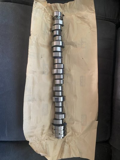

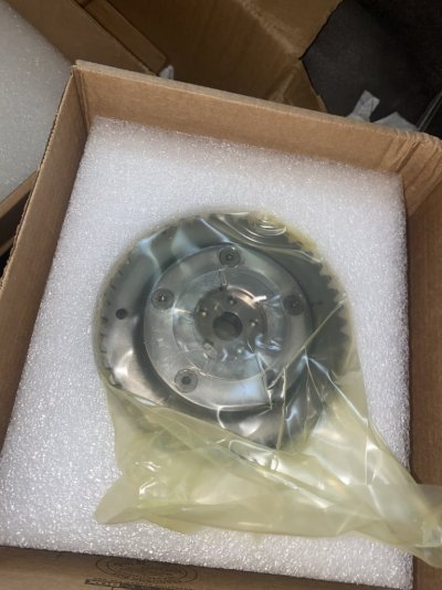

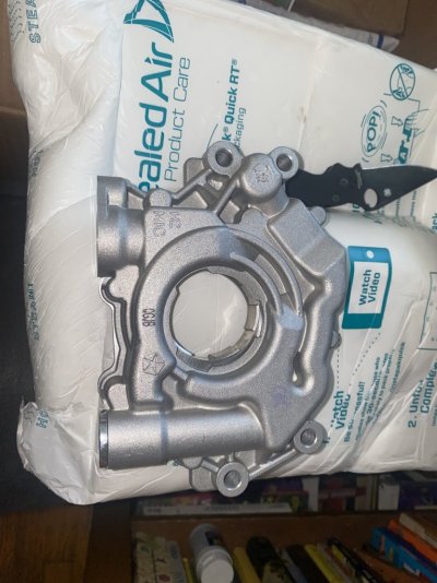

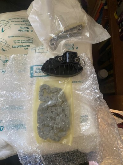

Update:
I’ve purchase the modern muscle xtreme mds delete cam kit for my ram. I opted in for everything as in mds plugs, hellcats lifters, hellcat oil pump , full timing set, predator programmer. I’ve got the kit in the mail. Just waiting till I get paid to go get some coolant, assembly lube, oil and filter, and I believe a water pump. Trying to think of anything else I need while I’ve got it torn down but this is what I can think of on the spot making this post.
I’m hoping to get it installed 4th of July weekend since it falls on a Monday, I won’t have to take it off of work.
I will post updates and pictures and what not of the journey.

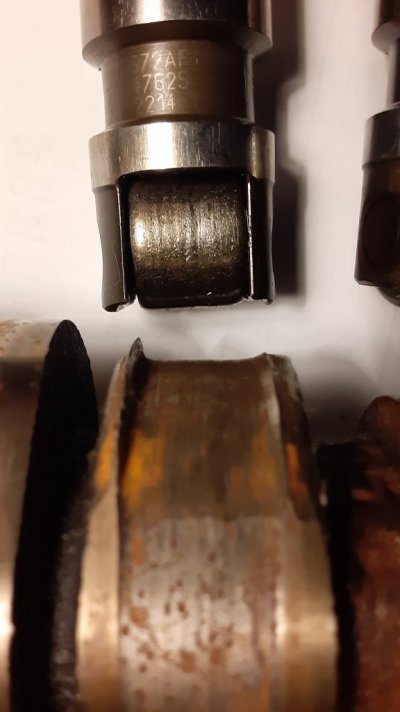

Old on left. New on right.
