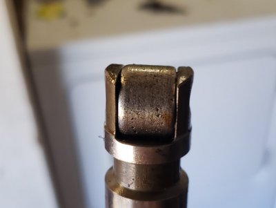

I also had to change lifters that's what ate out the old camshaft
