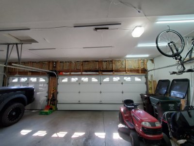

I have 7' doors now, and want 8s. I'm sure the header isn't on a load bearing wall, as the joist run parallel to the doors. I was thinking replace the header, but you bring up a good point in reusing what I have. It should be fine.
chrisbh17
Oct 12, 2017
6,720
7,527
View attachment 222882 I have 7' doors now, and want 8s. I'm sure the header isn't on a load bearing wall, as the joist run parallel to the doors. I was thinking replace the header, but you bring up a good point in reusing what I have. It should be fine.
Yep, I thought that way too but when it came down to it, it seemed senseless to make a new header that was the same as the old one. If I were going to a large single door, I would have bought an i-lam to span both door openings (I have 2 9' wide doors, similar to the left door in your pic).
The "hard" part was cutting between the exterior sheathing and the header, since the nails from the sheathing will go into the header. A good recip saw and blade for wood+nails made the job pretty easy. Any one that still stuck out a bit I just sunk back into the header with a hammer.

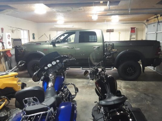

I ordered my PW then bought a house before it arrived.
I was pretty nervous about getting it in there but it fits fine...
