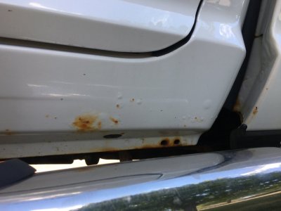

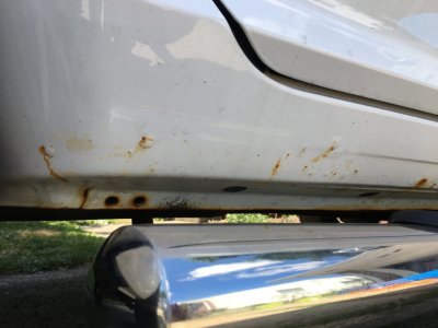

Here are the pics of the rocker panel.
Today I flushed them out with a hose (for the first time) and a ton of dirt and rust came out. Mind you I’ve owned this truck only for 8 months. I think it’s previous owner never touched them.
Should I bother spraying oil or something in there to slow it down?
I’m also considering getting it cleaned up as much as possible and getting bed liner up to the first line. I don’t want to make the rust worse though.

Yeah Bedliner won’t work. Rust will just pop through

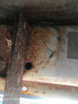

I got underneath my truck to do some cleaning, looked to unplug the drainage holes under the rocker panel, but then noticed the access holes inside were covered with loose tape. Furthermore, the one access hole on both sides, closest to the front, were both completely uncovered (no tape or anything). I bought the truck in October 2017... and didn't notice that lack of tape until now.
TadsRam
TadsRam
Jan 10, 2018
20
8
Lexington, Ohio
Hemi 5.7 V8
Wide open access hole
Wide open unused screw hole for step bar

My 2011 has zero rust there , back side and inside rockers - Not even a speck , seriously
Living in Salt WI Winter
That’s just a truck that wasn’t taken care of or washed underneath during winter months
RHeller
Nov 9, 2014
264
140
usa
I agree, my 2014 canadian ram looks like new compared to that. Did you look underneath before you bought it? There is no way it didnt show signs last fall with that much rust
