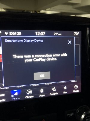

Mine was working fine yesterday but today it’s not and I’m getting this error. It’s a brand new Apple usb-c

Wow I haven’t seen that error yet. I’m really starting to believe the issue is software related. I notice if I plug my phone in within seconds of starting my truck my CarPlay works. If I wait too long it connects to the usb to charge but no CarPlay. I also notice that if the phone is connected to CarPlay and I unplug the phone, it’s not automatically connected to Bluetooth and I have to go into Bluetooth settings to connect and if I try reconnecting via usb it won’t connect back to CarPlay or even charge my phone.
