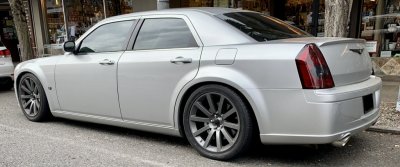

So, now, i’m out of a transmission, truck isn’t working, and pretty soon i’m going to need to tow a trailer to one of my work sites, and i can’t exactly tow with a Chrysler 300. Not to mention i’m out of nearly 2,000$.
