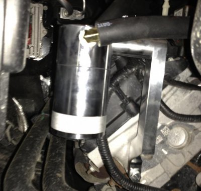

Matt the catch can came in and it was quicker than the throttle body! I couldn't wait more excited than a little kid at the holiday. Easy day next will be the vararam this week!! Thanks for the sticker!! You are the Man!!! thanks. EVERYONE needs to get one!!! Joe:party52:
window decal- little off center- no instructions LOL thanks
complete install
connect from rear PVC
Connect from front
5hole

Just got mine today and I'm not exactly a mechanic and messing with my own truck intimidates me. This looks straight forward simply attach the lines in no particular order and mount with the z bar correct
5hole
Feb 16, 2013
76
Also the extra brass fitting looks like it connected near the throttle body tube in the picture?
I really was super easy, the instructions show it all. take off the intake tube, engine cover, and then the PVC real simple. The instructions say the long hose in the rear and short with the brass fitting up front the hose just pushes on the brass fitting with no problems. From there attach to can but cut the hose if you need to, I did to clean it up, but it all fits under the hemi cover. There is a brass fitting for the front part that comes with the kit, and a 13mm bolt to attach to the engine head on passenger side. Took less than 20 minutes to do. Give it a shot, and if you need to ask questions let me know, I will help out how I can.

Looks good, and the install is super easy, took me about 5-7 minutes...I want to try the ported TB too.

mine came in today and took 10mins
