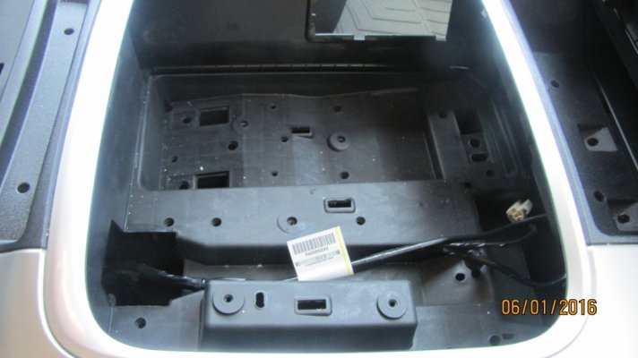

I have a center console harness. Looks like a small rodent has chewed on some wires. A red wire and the USB wire 68158774AC. There is a tag with bar codes that reads X40008801XX and X4000880 1XX6HY0421.
Is there any replacements for the entire harness or do I splice the red wire and buy a new USB cable for 35 dollars?

A new mopar harness is 75.00 to 120.00 depending on options the USB is included/wrapped in the harness.you can buy the mopar USB cable separate also.

Yes I just purchased the full harness was 78.00 dollars shipped same number as above contact Benny he helped me out

I also need to replace my center console wiring harness, bought the 2018 ram 1500 and found that the previous owner cut the harness somehow messing around so the usb harness is toast and the 12 volt in the back of the console doesnt work. My dealer here is an absolutely unknowledgeable to get me the right one. Is there some dealer or someone her that can actually get the right harness? I do know the usb media hub in my truck in multifunctional meaning both charges and data transfer for android auto. Please help and thanks
