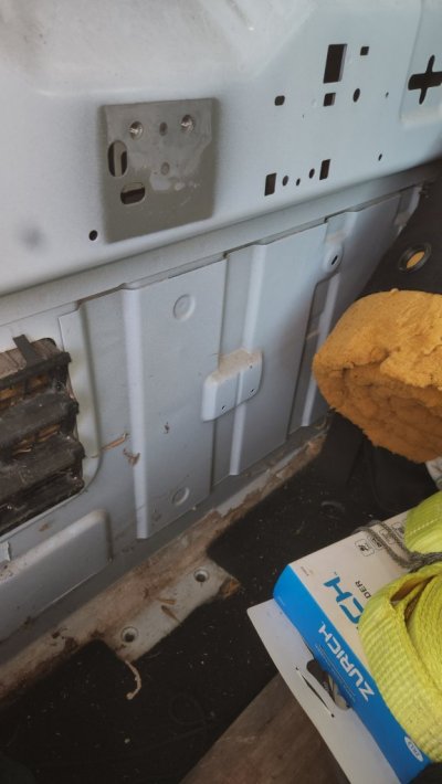

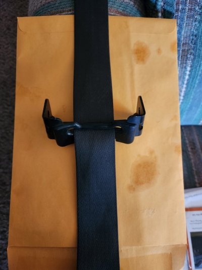

Craving an answer that even the Dodge dealer parts dept and body shop cannot give me on center seat belt attachment. I have the center seat belt to put into my 2015 Tradesman 1500 regular cab. There are holes in the floor to mount the reel. However at the upper end there are holes in the bulkhead to mount some kind of bracket apparently because the upper belt guide piece (whatever it is called) will not mount directly. Attached the photos below. You can see on the upper left the two threaded holes, and a picture of the belt guide and belt below. I've been all over the web and to the dealer 3 times to find out if there is some kind of adapter bracket available, no luck. Before i start cutting and drilling steel to make my own bracket I was hoping someone can tell me if such a part even exists and the part # if so. Thanks in advance for the attention.

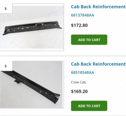

It looks like there are 2 different reinforcement panels available, depending on the layout. You may be able to order the panel and remove the bracket to weld onto your panel. You would also need the seatbelt bezel if you don't have it already.
Heres links to the 2 different panels. The first link is what you have, for a single cab. You need the second link, for a crew cab that includes the seatbelt guide bracket. That's the best I can gather. @AllMoparParts.com can confirm.

OK wanted to get back with the mystery solved. The original photograph of the back of the cab on my truck actually has the reinforcement panel ..848AA, the first one shown by the 18crew post. It dawned on me when the owner of a salvage yard asked me, when I showed him the photo of the part: "isn't that spot welded in place" and it is. So below is shown the two threaded holes circled, on the part from the 18crew post. Essentially what we have is the engineering accomodation for people like your truly to fit our own angle brackets, say made from 1-1/2 angle iron. There is nothing aftermarket ready made for this. No wonder the dealer couldn't help with this.

Right, so what I was saying above was if you want it factory appearance you would buy the new panel that comes with the bracket, remove it by drilling out the spot welds, then reweld it to your truck's already installed panel. Or like posted, remove one from the junk yard.
Dont forget you'd also need the plastic seatbelt bezel. It is listed under "seatbelts" in that website I posted above. Or again, get it from the junkyard.

You're welcome. Yeah you won't find just the bracket because it's part of the reinforcement panel as an assembly. Kinda like buying just the underhood reinforcements that are spot welded to the hood itself. To get them you would have to buy an entire hood.
