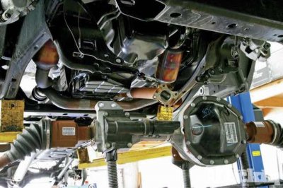

It only gets engaged/disengaged at the transfer case!
Take off a front wheel and show me where the magical locking/unlocking hub is. Tip: you can't because there isn't one.
jwheeler
Oct 11, 2014
1,537
419
Washington
2010
Put your head under your truck once in a while. Your truck doesn't have a disconnect on the RF axle?
