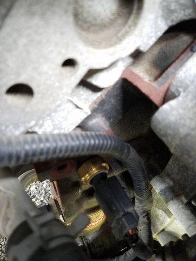

My pressure was similar to yours as well until the code would pop then the pressure read extremely high. Truck ran fine, just sensor was bad. I'll take a picture for you of the sensor. Just have to pop off the electrical connector and remove it with either a deep socket or just a wrench. You won't have to remove any other parts. It's a little bit of a pain to get too but nothing too hard. Just have to bend a little

There's an updated sensor for the 14's,they are prone to give trouble.Mine went at 28,000 started to have a minor seep,and the pressure reading was slightly high. As stated easy fix,a box end wrench should fit the sensor if you don't have the proper socket.

Picture not the greatest but it's the brass looking nut above the oil filter. 6fd3c5cb03929ce0f5fae62a350aa471.jpg
