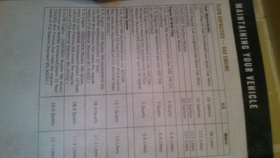

Here is a picture of my 2017 manual pp 292
Burla
Apr 28, 2012
27,542
57,751
2010 Hemi Reg Cab 4x4
I copied and pasted from 2017 rams owners manual online, dont know what else is there. nothing in either says dont use synthetic.
WiSH2oo0
May 15, 2016
378
143
MN
2017 1500 Express 4wd RCSB
Pp 293
recommends the use of Pennzoil Ultra 0W-40 or
equivalent Mopar engine oil meeting the requirements
For the 6.4l engine.
Also Pp 301 does not say to use 5W30 when towing. Towing falls under Severe Operating Conditions and requires more frequent oil changes.

Where does it say that? I looked and can't find it
