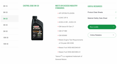

I would say around 2002 was the first time I saw extended performance, I found it thinner than the original formula. First picture look closely at it. Then extend performance. Basically cheaper for a reason. Crap. Then in 05-06 they changed the bottle and it started saying super syn tech that is when I noticed it got super thin. I stopped using it and switched to Royal Purple. We were talking about why GM swore by Mobil 1 back in the early LS days. It was good. Something changed. They changed. Sorry, I needed to revise this to make more sense. I have my amsoil theory as well as I watched a 347 when amsoil got big go on the second oil change due to absolute crap lubrication. NA dialed in perfect. 06. I won’t open up that can of worms. I have grown up around racers, hotrodders, and fast things my entire life. I grew up building them with both grandpa and dad. I hold a certain level of quality. I’m glad pennzoil has come up. I never personally liked pennzoil anything. It was always super thin and looked like water, regular motor oil.
