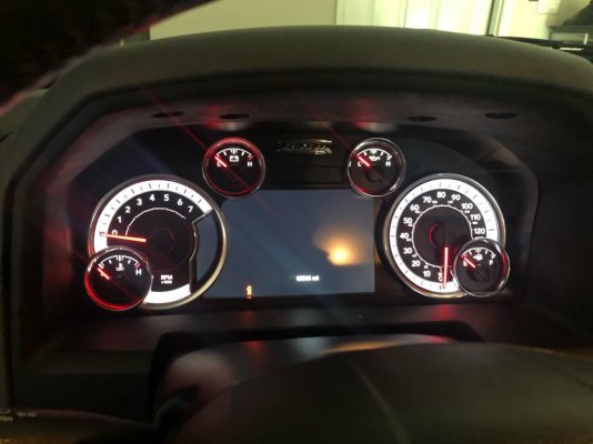

My cluster was recently swapped under warranty. Evidently RAM uses a certified refurbished. That said, I think my new cluster is different, possibly from a Limited/Laramie. I don’t recall chrome bezels around the dials or the needles being so vibrantly orange.
Any idea to know if it’s legitimately an upgrade or not? Tell tale signs?

The Laramie, Laramie Limited and Longhorn clusters all have completely different dial faces. It would be hard not to clearly see the difference between the three of them. All three of them have chrome rings around the dials. The Laramie, Bighorn and SLT when equipped all use the same premium 7" cluster.This is assuming your truck is a 4th gen.
