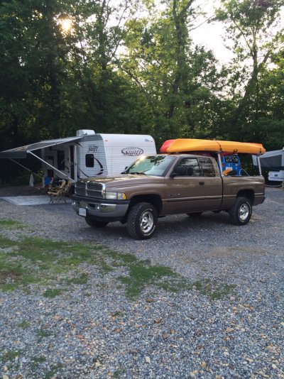

I just installed a 1ft piece of heater hose onto the nub of the ac condenser drain on the fire wall. I think that it’s going to solve the problem of my wet carpet. Been that way for years. I pulled the carpet back to dry out. I was amazed that there was no rust. Next project is headlight replacement.ac58746c91e67ac3720b78ce53c3e3e0.jpg

That's a sharp looking truck and I am not generally a fan of brown trucks.
