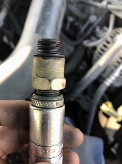

Ok guys quick post. Checking plugs out and I found this on the end of my plug. What is it

Not sure if this is the correct name but it's a non fouling plug extender. Apparently that 1 cylinder has been pumping some oil fouling the plug.

^^^^ Yep. Designed to pull the spark plug out of the " Dirty Zone " You can always just screw the plug in without it see what happens but probably foul it out pretty quick but before it does it will smoke some. Had an old Camaro do this once.
Sent from my XT1650 using Tapatalk
Ok well should I do away with it or should I keep it bc plug doesn’t look fouled

Well I’m getting a cylinder 8 misfire that’s were it came from to

I'd put in a new plug and if that corrects you're missfire even just temporarily before it fouls again I'd be checking the valve guide seals.

It’s called an oil fouler. It helps that particular cylinder from fouling the plug because that cylinder is burning oil for some unknown reason

Well, I would try the plug without and with the fouler if you have to. See where that takes you, may possibly have to use the fouler and a hotter plug in that one cylinder. As long as you can deal with it i would run it, but if it keeps fouling or smokes too much then maybe an engine. My problem was my rings but i wanted a bigger engine so i did that.

While your truck is running pull the pcv hose and see if its is blowing lots of smoke or air. if so thats blow by ( Probably worn rings.)

Cylinder 8 fouling is a pretty good indicator of bad plenum.
Somebody found the plug being fouled and rather than fix the oil burn and plenum issue they used a fouler

Bad plenum gasket or plenum itself
