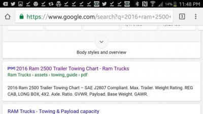

If you want to get a general idea of these numerous Google "20xx ram 2500 payload" put in whatever year and if it's a 2500 or 3500 and you'll find this site..... it's a PDF, it's easy to use and I'll show you a page and what the Google link to click on looks like below.
https://www.google.com/url?sa=t&sou...TwPvKBrbyX7CLGvTQ&sig2=biABs1o6s-AYRTZf2FC3eA
