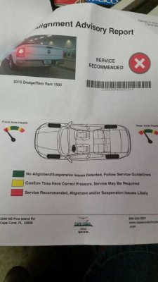

When I was at about 45k miles, I took it in to get recalls done, and they showed me this sheet how my alignment was off front and rear. I asked how it was possible with no pull, and even tire wear over the approx 18k miles since I had it. The service guy stammered a bit and said, "You're not the first to say this. Maybe our machine is off." Yeah, maybe.
