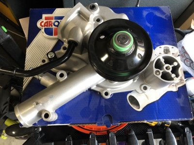

Got the pump, limited lifetime warranty and the dude behind the counter floated me a $20 coupon. Thing only cost $80.
Traced out the unit and its 12 bolt holes. Apparently these things have different sizes all over it, so as I pull one, I will put it in its place.
Gonna get a cup of joe in me, drop a deuce, and turn on some F'n fans in this here hot garage. OK, too much info, I get it.
View attachment 134277 View attachment 134278
LOL
I'm curious to see what the impeller looks like and how bad the proceedure is.

Suspect we will be seeing more coolant threads as we gut out this hot weather. It will help all of us to know what the outcome is. We know your vehicle is well maintained. As said, many of us would enjoy being there helping you if we were closer. Looks like a quality pump. Fitz (enjoy??? that could be suspect)
