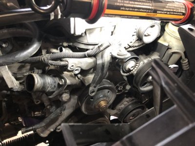

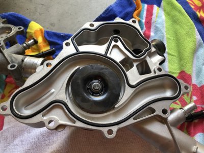

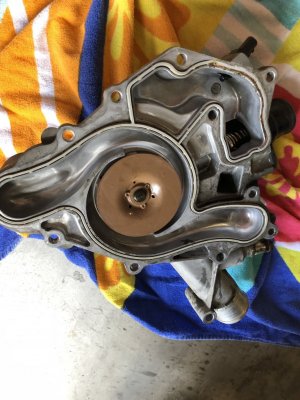

131k... most likely the water pump

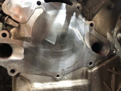

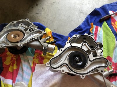

Look at the bottom of your old pump there should be a hole in the casting. If water was leaking from there then pump is bad.

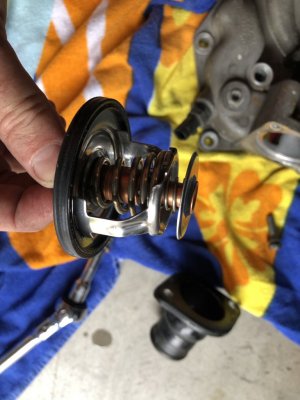

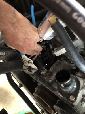

Possibly. I will let it cool, then pull the bleeder plug and go with it until water flows out, then reinsert. Craziness.Well that blows........

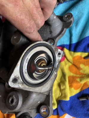

When I flushed my coolant without the tstat installed it wouldn't go above 150*. Granted it was February in New England but still with all that coolant going continuously through the block yours shouldn't be much higher than that even in the summer in Texas.
How did everything look inside? Clean? Corroded?

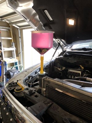

EDIT: Did you pull the bleeder plug out when you filled the system with coolant? Could it be airbound?
