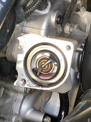

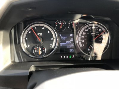

Well, well, well. I pulled the T-stat, left the gasket in, bolted the radiator hose back up, filled the radiator and fired her up. I turned on the heater first, to get the coolant thru the heater core then I went full AC. She never got hotter than 190. I was giddy, so I got behind the wheel and jumped on the freeway. Never above 194, YES! Then I got off, found a vacant parking lot, put her in park and rev'd her to 5K RPMs for 2-3 minutes. 228 is the highest I went. I pulled out and headed back home. 228 -- 225 -- 220 -- 205 -- 190. I was cruising thru town at 40 mph and it was 95 degrees outside.
I undoubtedly replaced a water pump that did not need replacing (but at least it's new and hey I know how to do it now). I am cancelling my order on the new radiator and hoses. I have a JET 180 T-stat coming from Matt at MoesPerformance early this week.

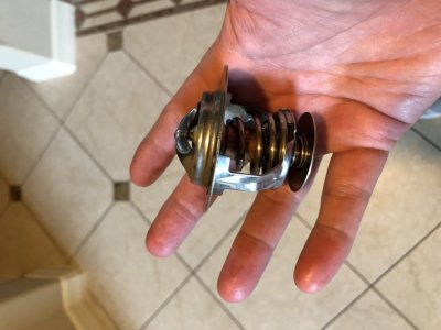

So this CST T-stat looks innocuous enough. No visible defects. Wonder why the failure.
Can I drive this baby until my T-stat comes in? I essentially have to get to operating temperature before I put it in gear?
Thanks everyone for your advice and comments. I really appreciate the insight -- especially to those of you who said that T-stat could be sketchy even if it is relatively new. I will know for certain once I put that Jet T-stat in.
Incidentally, that is 2500 RPMs at 88Mph on 35s with 4.56. So for those worried about redlining on the freeway, nope!

It's not that uncommon for a t stat to go bad. No you don't have to wait for the temperature to come up before you drive it. Get in and go like you normally drive. Run the a/c like u want

Glad you found the problem and that it's a relatively cheap fix. A new water pump at those miles is probably a good preventative thing to have done anyway.
You can run that no problem without a tstat, especially where you live.

Just catching this thread. I immediately thought thermostat. I've had a couple jet 180 thermos go bad after 36 to 50k miles. You also need to make sure the burp valve is at the 12 o'clock position. That sucks that you just did a coolant flush, but like you said, at least you know the water pump is good now since that was a matter of time. If I were you, I'd upgrade the radiator hoses while you're at it before you put the new thermo in and top it off. Radiator hoses are another one of those long term/high mileage things and it sounds like you plan on keeping the truck for a long time. Glad you figured it out. You'll be fine without the thermo for now.

So Jay was right all along, it was the t-stat, I’m glad you got that figured out.
With that many miles on the water pump, just look at it as preventative maintenance
