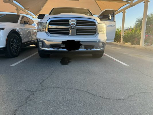

Now, i have intermittent leaks sporadically on the passenger side. Some days i can park and come out later and There is a puddle of coolant on the floor. Some days the truck can sit for a few days not drive and there will be a puddle… And I find myself adding coolant every 3 months because the reservoir is bone dry and truck starts to get to 230’s while at idle.
I added coolant yesterday from local part store, and was driving back to work and the temps would fluctuate from normal temps to borderline over heating and then drop back down.

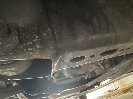

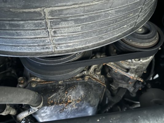

I will include pictures of what it looks like underneath my truck. I see coolant on the crossmember that is fresh. I want to say it may be coming from the lower hose, but can’t say for sure.

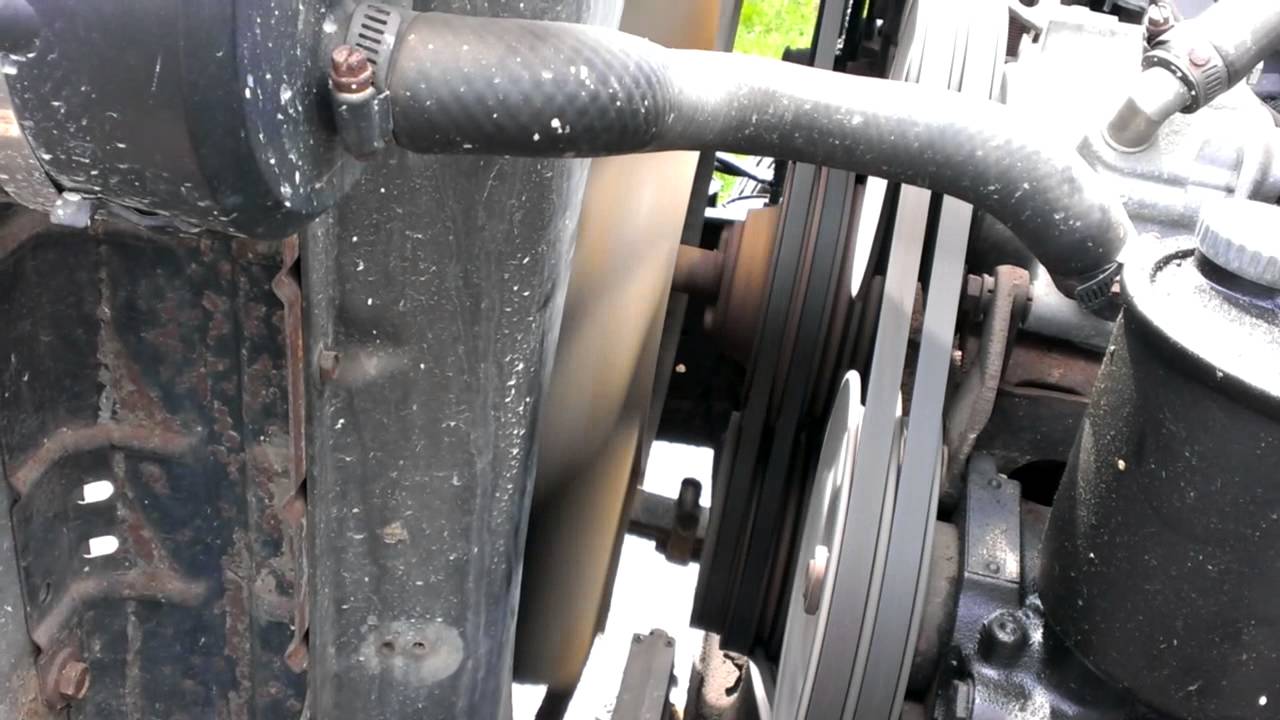

If this is happening at really low speeds, like idling, stoplights etc, my first guess would be the fan clutch. So, with the engine off obviously, go give the fan a push/pull and see how much resistance the clutch is giving.
Like so:
And

I replaced the fan clutch when I replaced the water pump. It was a whole lot I got the local auto parts store.

I am unsure of where the leak is. It is random when it does leak. It is usually in the front right of the truck. When I looked underneath today, I saw fresh coolant on the lower engine hose and on the crossmember.
