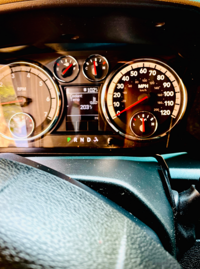

Heres a pic from my truck i have no clutch fan no heavy duty V6 fan nothing just the factory stock electric fan one small pusher fan no thermostat no rad louvres been over a year no problems at all.. not recommended for people in colder climates

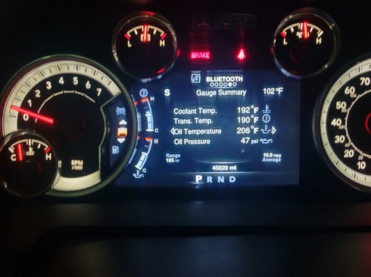

Just went from FL to NC and took these of my EVIC in SC cruising at 72 mph.
Mileage hand calculates at 21 mpg, I forgot to jot the mileage down when I filled up.
2015 Ram 1500 QC 5.7L 8 spd 2wd, 124k miles. Bone stock.
If you're running 203 with "no" thermostat,with an extra front mounted pusher fan,you'd be better off throwing a 180 t-stat into it,as the trucks run cooler then that by a long shot with a 180 t-stat.Most trucks with a 180 run right around 185F.Taking the thermostat right out and not putting a restrictor plate back into the thermostat hole to slow the coolant speed down,usually means the coolant circulates to fast through the engine to actually absorb the heat from the block and heads
THAT LOOKS NORMAL
Good point about the restrictor might try that thanks..i just wanted to show here that the stock factory electric fan on its own is more than enough to cool this beast in extreme heat didnt even need the pusher fan.. that front pusher fan is just an after though to make my AC a lil colder.
