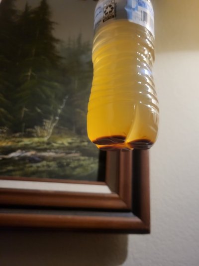

My truck had factory coolant until I got it in 2024 and the build up is still coming out like 5 flushes later. And I wondering how much the build up is effecting my cooling capacity.
Or maybe my radiator is actually a tang dispenser

I was thinking it was the oem coolant crust because it ran within what I assume the ranges should be until the vinegar flush passed though the heater core.
I did my flushes in stages because the build up was so thick
1st 24 hour soak 1:3 vinegar in radiator only, and ran heat for 2 min before dumping.
Ran normally in-between.
2nd flush t-stat swap with radiator and engine block flush but did not run heater so vinegar could soak there.
After turning on heater my temps shot up.
From 3rd flush on... I've been dumping the radiator and flushing with only distilled water until clear, then I ran the heat and park it for the night.
and no I did not flush the heater core in reverse the kit was still being delivered when I started and I haven't had time yet. Plus I was hoping I wouldn't need to, but distilled water is adding up.
