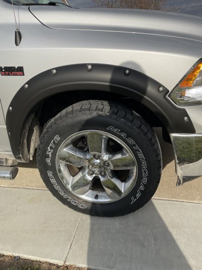

I had Coopers several times and never had a issue. Last month I opted for Mastercraft Courser AT2 all terrains. They are made by cooper and are cheaper. They are great. Quiet, smooth, grip well and super great on wet roads. They balanced with very little weight. They are way better than I ever expected.

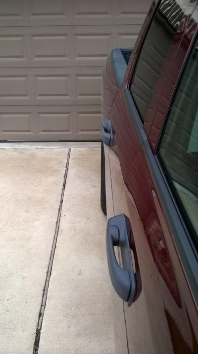

@Jasfish18 , not much. I prefer the cleaner look myself, so I don't use spacers or anything like that.IMG_20210921_073517791.jpgIMG_20210929_112428820.jpgIMG_20210929_112528869.jpg
For reference, here are the stats on both the Cooper Discoverer ATP:
  • Diameter: 32.83 in
  • Width: 11.4 in
  • Weight: 55 lbs
  • Speed Rating: S (112 mph)
  • Load Index: 121/118 (3195/2910 lb @ 80 psi))
  • Load Range: E1 (10 ply)
  • Max Inflation Pressure: 80 psi
  • Wheel Width Range: 7.5”-(8.5”)-9.0”
  • Tread Depth: 0.531 in
  • Rev/mile: 633
And the Rebel replica wheels I have them on:
  • 17 x 8 5-139.70 Hollander
  • Offset: 18.05 mm
  • Bolt Pattern: 5-139.7mm
  • Hub Size: 77.8 mm
  • Back Spacing: 5.21 in
  • Material: Aluminum, polished with painted inlay
  • Weight: 26.5 lb
