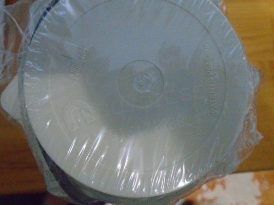

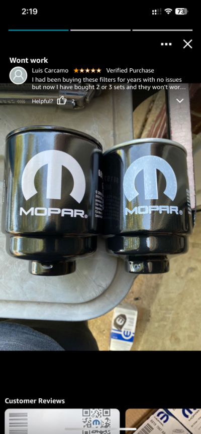

I am late to this party but wanted to say a couple things.
First: Fleetguard and Mopar fuel filter by the engine are the best I have found rating wise and they are literally the same filter as the Mopar one is just the Fleetguard in different box. I had injectors fail and truly think using Napa filters contributed to it. I bought my truck used and no way to know for sure but that aftermarket filter is completely different design and not rated for 3 micron from what I can tell. It was a wix from Napa when I bought and I think previous owner used them all the time. Injectors failed around 180,000 which isn’t terrible and there may have been other factors.
Second: The rear filter with water separator is Parker/ Racor I believe so when you get a mopar one it might be different rating than a Fleetguard in back. I use Mopar ones most of the time but have been looking at Fleetguard for that spot too.
Lastly: Watch out for fake/ counterfeit units online. I bought an oil, Fuel, fuel-water set on Amazon from Woot and got counterfeit set which I returned. It is very important to get legit Mopar or Fleetguard as the Chinese knockoffs are pretty tricky at looking legit. I do believe the real Fleetguard is always USA or MEXICO not China. Pretty easy to spot fake when it says “Fleelguard” instead of Fleetguard. The water separator is harder to tell but left is legit and right is knock off. I got that picture from someone else as I didn’t have a side by side at the time. I don’t know how to tell on the oil filter as I don’t use Mopar ones only the LF16035 which is the stratopore one.
On the filter you say spells Fleelguard, I have to ask did you use a magnifying glass to be sure that what you thought was and L was really an L and not a small printed T? I looked at my Fleetguard 53000 and being its still wrapped in plastic I had to get a magnifying glass to be sure if it was an l or a t, in reality with the magnifier I could see that its a small printed t that to the naked eye looks like an small L.....

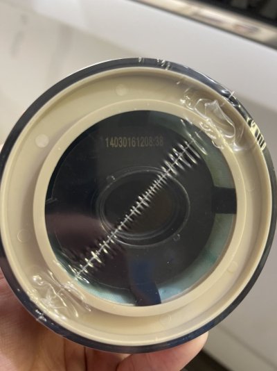

I've made multiple posts about the counterfeit rear fuel filter and how to find the differences. Everyone we were able send back and were bought off Amazon. One seller questioned it and I believe he didn't know he was reselling fakes.
Alot of them are detected by the fonts being slightly off. I used the above Fleelgaurd photo and a known real one.
Suspect fake below
Authentic below
Thank you! My hunch was fake but is didn’t have another on hand as it was already in my pickup. I usually keep a set on hand incase and keep them with my pickup in the event I need them on the road. I saw this when I opened it and thought this has to be fake. Looked online and saw a lot of people saying fake but didn’t see a real one to compare. Thanks again!
I know it is fake it just has to be. The writing where it says “Turbo Diese” isn’t on real ones.
I again have to ask did you use a magnifying glass/loop when looking? The reason I ask is I have one where the letter L in diesel is tattooed on the cap top of the the injected molded words on the cap top, other that the L being tattooed in the wrong spot on the cap that could of happened from it being misloaded into the machine is identical to another FS53000 filter I have on hand... But to be safe I will be calling Fleetguard on Tuesdays asking questions about it....

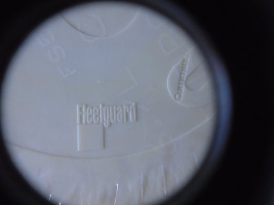

I don’t have one to inspect now. I sent it back. Do you see all the other writing on yours? Put up a picture would love to compare.

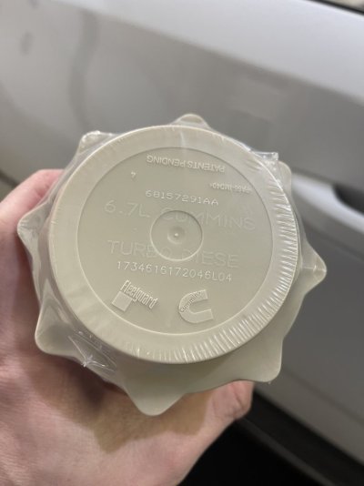

I have tried to get good photo for you all, but I will to take it out of the wrapper to get you great photos, the photos I post below are the best I can do... I was surprised how hard it was to take photos of the filter top with the cellophane wrap still on. As you can see the first 2 photos the tattooed letters run into the molded words for "patents pending" in the photos for my other FS53000 filter it does not because the top was rotated slightly so all the tattooed letters show up, this is my guess at this times based on the difference between the 2 filters... BTW like I said above I will be calling Fleetguard tomorrow asking questions about this.....
Looks like you got a fake too. Real ones don’t have the extra stuff on there like “6.7L Cummins” and “Turbo Diesel” as far as I remember. I hope I am wrong.
At least yours is spelled out fully. Mine is missing the “l”.

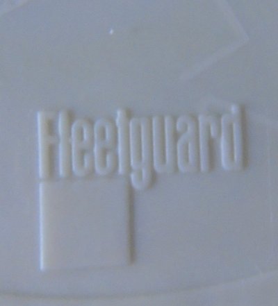

I took another look at the photo you posted and noticed its tattooed with a Mopar part number not a Fleetguard part number so it makes it a bit harder to compare to the Fleetguard I have that you say is questionable out side of the fleelguard, but I will still make the call tomorrow to be safe...
06 Dodge
Jan 4, 2022
2,850
3,421
6.7L CTD
Well yours atleast looks like a " T " to me. Plus look at the " g " in comparison to the fake in my post #49.
I took a few photos of the questionable filter so you can compare it to the photo you posted above, will post your fist then 2 phots of mine. That cellophane sure does make it hard to take photos as it reflect light that my camera hates... Edit just found a way to enlarge an crop the photo to make it easier to compare my photo to yours

I think yours is legit. It makes sense to why they wrote that on the newer ones. The unit I posted is indeed a Mopar boxed one. My truck currently has a Fleetguard boxed one which I haven’t wanted to open up housing to see how it looked. I might just go up to the dealer to get one to be safe and compare.
