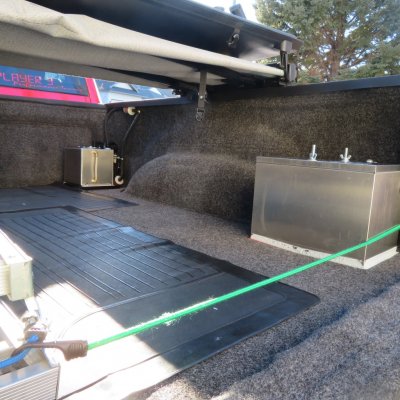

That's a wise move.How big a shot are you planning on hitting it with.Anything over a 100 shot,you should seriously look into doing a seperate stand alone fuel cell dedicated to the nitrous side of the fuel system.The stock system goes instant lean,as soon as the fuel solonoid opens and takes a bit to catch up,leading to an instant lean condition,lean and nitrous don't go together very well.I've been playing with nitrous since 1981,and have learned a few expensive lessons over the years,one being,do not short change the fuel system,and the other is,leave the purging for the guys on TV,it won't gain you squat on anything under a 250 shot,and just wastes nitrous.I run a Nitrous Outlet stand alone set-ups in both my truck,and the wifes 1320 Challenger. This is the one in my truck.
This is the fuel cell i use in the wifes Challenger.
Fuel cell is in the front pass corner of the box,relocated battery is in the rear pass corner of the box

I think 100 would probably be my limit. I'm just trying to get into the 12s consistently. After the tune, I'm going to do some interior stuff for comfort (speaker upgrade, a console idea I'm batting around). After that, it's a set of tires, a driveshaft (probably first since I don't drive much and these stock ones appear to be lasting). Then it's the manifold, lastly the nitrous.
So if I understand right, that's a little tank of regular gas that gets pulled only when you use the nitrous?
Yup,but i run race fuel in the stand alones.MS109 is what i keep in the small tanks dedicated to the nitrous.You'll be easily into the 12's on a 100 shot.Figure on taking close to a full second off your times with a 100 shot.My little regular cab fully loaded 4X4 Sport runs DA corrected mid 11's on a 75 shot,with stock convertor/3.55 gears with a True Trac posi unit / one of Jays smaller 1.5HL cams / JBA 1 7/8 long tubes with a 3" true dual exhaust and the earlier Illicit relocation brackets. You'll want to invest in a set of 17" drag radials as traction will be your biggest issue.It could stand a convertor for the times it's off the bottle,but on the bottle the stock convertor works pretty decently.Nitrous creates instant cylinder pressure which is basically torque,which will blow the back tires off on street tires,lol.
