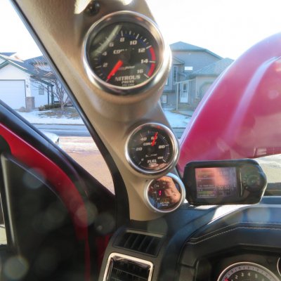

Wide open throttle switch,but i have the arming switch mounted in the console,where it's easy to get at,so if things are sketchy,i can manually activate it,when i want.Invest in a bottle heater and nitrous pressure gauge,that way you can keep the bottle pressure sort of optimized. I have my 15 lb bottle mounted behind the drivers seat,so it's easy to get at,to open,and it's hid under an old suitcase,keeping it out of sight,lol.S hitty pic,but there's a 15lb bottle under the suitcase.I run a fuel pressure / nitrous pressure and A/Fr gauge in a pillar pod
