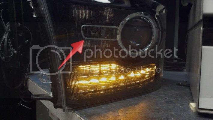

I have the 2013 projectors and I want to put LED cubes in them as high beams (like in the picture below). However, there's that plastic piece that sticks out into that area and I wanted to know what ideas y'all have about cutting that piece out.

dremel.

That would look cool but damn are those lights expensive to be cutting.

its just a shroud.......2 little parts 1" long, 10 seconds to cut then sand, done.

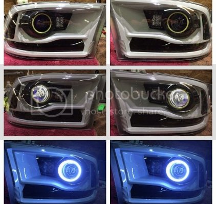

those headlights look awesome, haven't seem that ram projector before either, is that how they come on the new 14s?

No, that was custom made on that set but that would be sweet if they did come like that

JJ's work or someone elses? JJ if I end up getting a truck when I get to Hawaii you can expect a call, whether these are yours or not, please don't kill me on shipping.

Someone elses

Hey JJ I have another question. How can I make that turn signal piece black like that? I emailed the guy and he said it's translucent but didn't tell me how he did it and has yet to reply to me again.

We just use a "tint" mix of our gloss black.......translucent, spiffy, but damnit thats dark and....well.....I'd want to see 'em lit!
