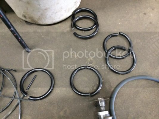

I wouldn't bother picking up a set of 2" springs unless you plan to return it to stock if you ever sell it, then it'd be worth it. You don't need to change shocks for only a 2" drop, and cutting your stock springs is a viable option, just take your time and cut a little bit at a time, reinstall and remeasure. I just cut down a set of 2" drop springs last week and they were in/out of the vehicle 5-6 times to get it where I wanted it to be. Also, rotating the spring in the pocket allowed me to fine tune the last 1/4" and now the rear is dead level side to side with a 1" rake front to back.

I did this on my 2011, and now my current 2013. I did .5 coil on back and rear 1.5 coils. The rear is so pathetically easy to do, just the front springs can be a rear ***** getting out and back in (driver side was hardest for me). However, truck sits cleaner now IMO. Looks more sporty and rides the same. For the time put in, you save yourself $400ish for a kit. All is needed is time and tools.
